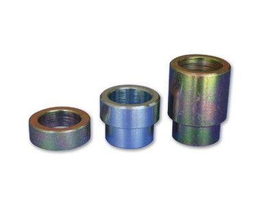

Does the car have caster camber plates? If so did you move the shims over from the old struts to the new ones?
CC plates have metal shims some are 1/4, 3/8, and 1/2 etc... You can use them to change ride height and get the postitioning right of the strut nut on the strut when its in the CC plate. If you didnt change them over you will lose ride height.
yes, everything stayed the same aside from swapping the lakewood out and putting the strange in
IT might be that the ends are different....Look were the nut goes and were the spacer would fit on the shaft the new ones might have a longer tapered area....So you might need a longer shim to make them the same height....If this has been said please dont leave neg feedback....
