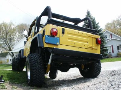

what the hell happened to that thing? looks like one side of the rear and front are lifted at opposite corners.
:lol: its my brothers, articulation is what it is called. Sway bars are still connected in that picture. Its something 4 wheel drive vehicles do :lol:
