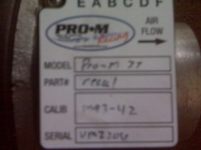

Get me a picture of the top of the maf sensor. I need to see what the part number and calibration are.
Here is a pic of the maf, sorry about the poor quality. And I guess its a 77 not a 80.

I bet the Maf calibration is wrong. Those unit had horriable issues especially from the time span that unit was recalled right as they were going out of bussiness.Is the sensor housing plastic or aluminium???
