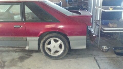

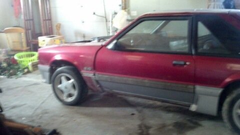

I bought this car as a roller for $600 with new carpet headliner and wheaterstriping. using the part I collected from my notch. I was going to paint it orange. but I change my mind. might me easier to go black and titanium. save me some time doing a color change and I alway like that combo. Nothing special just a clean driver for now with a/c.
Engine
306 with flat tops, e303 cam, gt40p heads, cobra intake, 24 pound injectors, 70mm t-body,bbk headers.
Trans
t-5 from a 95 gt
3.73 gears
Wheels
93 cobra wheels from NPD
exhaust
bbk h pipe with magnaflow cat- back
Body mods
black and titanium, cobra grille insert, smoked lx tailpipes, cobra r hood.

Hey Dan, Do you know the Imput shaft and bell housing on the 94-95 Mustangs are 3/4 of an Inch longer than a fox T-5 ? It may play havic with your drive shaft. I have a fox T-5 and bell here (In Westland) If you want compare. It Is a cool project.
