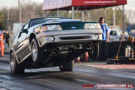

92 Mustang GT Strip/ some street Emerald Green/titanium
fyoung7
price 17300 FIRM
92 mustang gt
power windows,locks,mirrors & hatch release work.
street or strip
427 stroked DART shp block, never sprayed
SCAT forged crank & rods
DIAMOND PISTONS
ARP head studs/rod bolts
EDELBROCK 58cc vic jr cyl heads some bowl work & bigger intake valve. super vic intake
COMP CAMS, camshaft,solid roller,ultra pro magnum rocker arms/jomar stud girdle
QUICKFUEL 850
Manual brake conv.
STRANGE brakes front & back
maximum motorsports manual brake pedal(for correct pedal ratio)
CHAMPION cap 5 wheels
15x3.5 2.25 backspace front, with brand new M.T ET FRONT TIRES
15X10 6.75 backspace (tuck tire more, yes they fit no they dont rub). M.T 28X10.5 STIFF WALL USED.
rear
STRANGE new 35 spline street/strip axles,5/8 stud,strange spool,456 gear
9 inch bearing ends
STRANGE adj shocks
TEAM Z double adjustable lower control arms
TEAM Z relocated upper control arms
TEAM Z anti roll bar.
front
QA1 k member
TEAM Z 1 inch shorter adj a arms
TEAM Z travel limiters
STRANGE adj coilovers shocks
BEHIND BARS RACE CARS stock location fuel tank/ fuel cell. 13 gallons
fills from stock location
MAGNAFUEL quickstar 300 pump/filter,fuel log & regulator.
TKO 500 trans faceplated by LIBERTY
QUICKTIME bellhousing
FORD TAURUS FAN, aftermarket fan controller on 185 off 175 soft start motor switched also in engine bay
to turn on if you want to keep the fan to cool down more while sitting(between runs)
