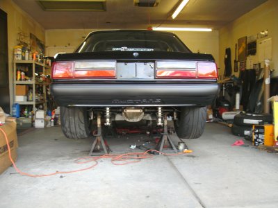

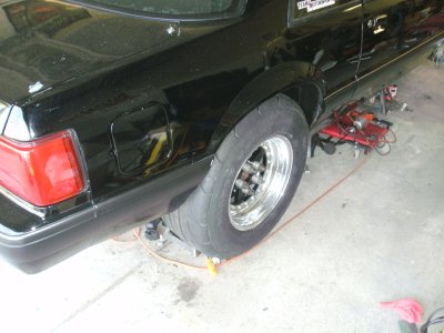

hey guys i have a 92 mustang 8.8 rear is cut 2 inches per side aerospace disc brakes tryin to figure out back space running 28x10.5 15 slick any ideal or pics on back space i would need also doing a beadlock rim thanks guys on a 15x12 rim
Stock fox width is 6.5" b.s on a 10" wide rim fitting a 28x10.5 without mini tubbing so you took 2" out of each side = 8.5" b.s on a 12" then comes 3/8" per side to subtract for rotor hats on aerospace brakes extra thickness so 8" should be where you need it.
i say this is wrong....i'm thinking 6.0-6.5
