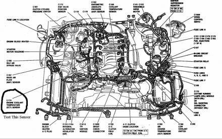

I am for sure that is is plugged in. Whether or not it works is something I can find out. What is the resistance values? Hot/cold
This is the diagram I have been working with for sensors. (see attached)
