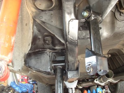

My family and I are redoing a house, its going a lot better/faster than expected. For once I'll be able to have my car apart indoors for a days, and be able to fix/upgrade stuff. My POSI is so/so, I'll be doing 3.73 gears, clutch pack, lower control arms in a couple months. Any recommendations while I am under there? I've never done this before, so it'll be a trip..
The car makes maybe 220ish hp, its a T5 trans. I understand the 8.8 is strong, and I will break my T5 again. This is my summer driver/weekend racer. This winter I'll have either a nitrous/C4 setup, or a 351.

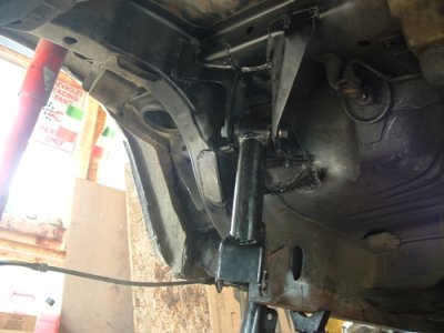

x2 on welding your torque boxes, 6k with slicks will rip them apart fast. look into the battle boxes.
