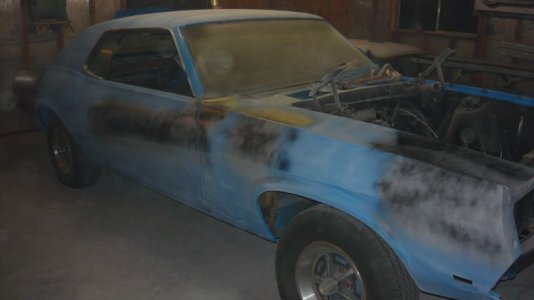

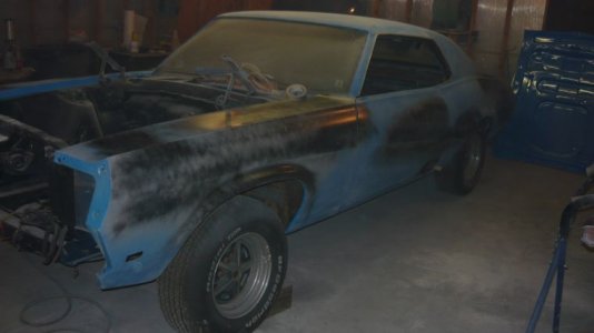

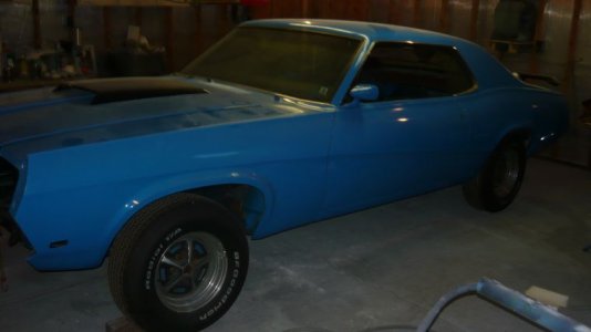

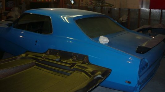

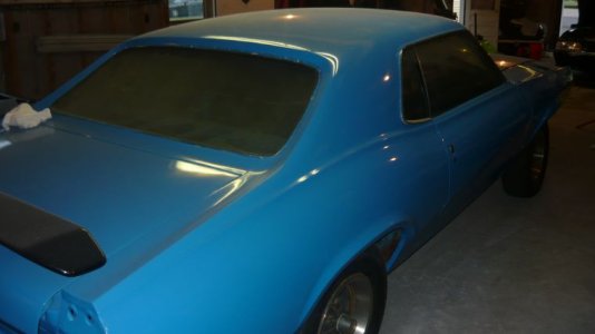

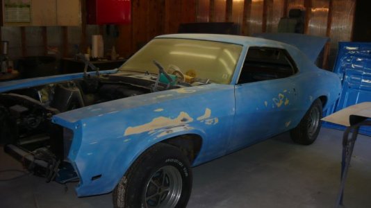

I am Painting this car for a friend, he had done a couple years back but whoever painted it didnt prep it very well. You can still see the sand scratches through the paint. Plus he got overspray all over the place, so Im going to clean it up sand it all down and re spray it. when im done Ill trim black the nec. spots and undercoat the living hell out of it. Hope to move along on this project so Ill try and keep it updated. Sorry for the lack of light. Thanks for looking.

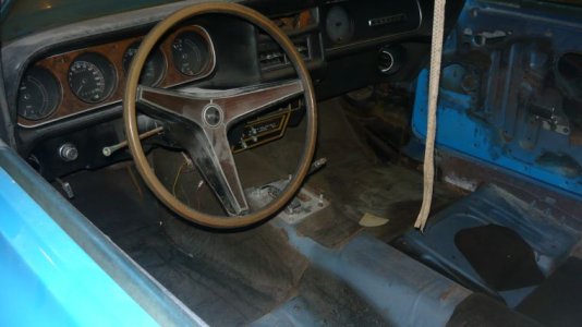

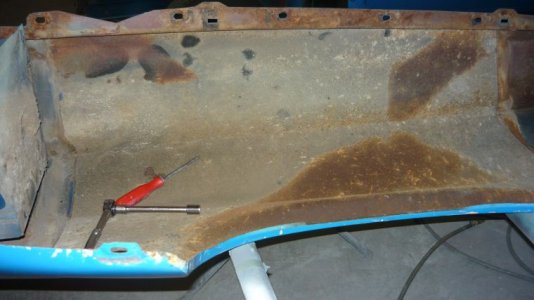

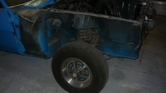

Couple pics of the interior and fenders with the fenders off gunna clean em up tommorow. Grind down the surface rust and undercoat the fenders and inner wheel wells.

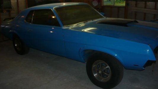

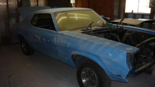

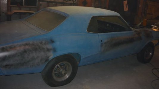

Its been a while but since then I blocked the whole car down, there were a tun of high and low spots. Ive got it all primed up and a coat of black guide coat on the primer. I will start wetsanding the whole car down again and get ready for paint. Need to get going on it, the snow is going to be flying soon.
