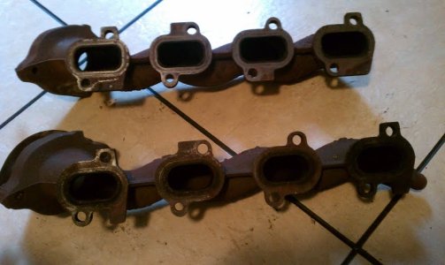

In reference to the exhaust ports, they are not the same. B heads are different than C heads.

03-04 heads have larger exhaust ports, and require 03-04 manifolds to flow properly. You will be choking them with the 96-01 manifolds, but they will physically bolt up.

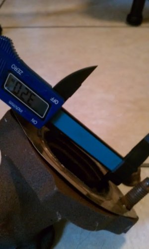

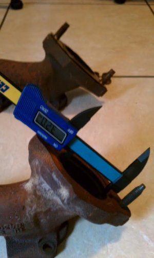

ya I got that part, I plan on using the 04's & a 97 H pipe. but I still need to check with a measuring caliper for the output.
The ports are larger for sure lol, but not on the output end! I found the 97 manifolds have larger studs then the 04 on the output end! but the gasket/seal fits both style manifolds.
