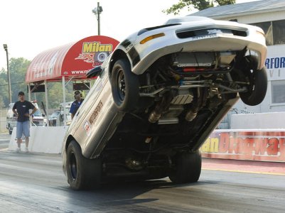

need some picture/tips or pointers for a 99 camaro about to start ordering things i have a 9inch in the rear with a tunnel mounted torgue arm thats it. any info or pictures woould be appreciated
DA rear shocks , spohn or bmr dragbar(unless a full race car then Wolfe ) lca relocation brackets
its added support for the TA mount.. some people do take it out though
i really just want ppictures to see how some fast fbody r done.
i got qa1 coilovers
relocation brakets
cage
subframe connectors
lca
short tunnel mounted T/A
like what is the top bar above the panhard bar? can i take that out?
Sphon pro series TA, wolfe anti-roll , strange coil overs, leave the upper PHB support bar in, def get lca relocators
got it sitting 28imches in the rear as to were I wanted it to be at. And now I just need front Coilovers![]()
