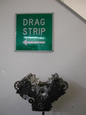

Ok...about two years ago I bought a teksid block off a member here and have been piecing up my new motor to be built OUTSIDE the car. i didnt want to tear mine down until my new one was done and John from MP emailed me this morning and IT is JUST about done. So my stuff will be getting
specs:
4.6 stroker- 302ci.
Kellogg 3.80 stroker crank
5.95 oliver billet Rods
9.3:1 diamond custom stroker piston
2003 heads-stage 3 cnc with foxlake racing 9 thread inserts
.50 oversized intake and exh valves
custom cams-.485” /.475” spec'd by john
Power adder will be a F1a procharger blower and A/C..
NOW time to sell the stock motor and trans which doesnt even have 9500 ORIGINAL miles on it.
