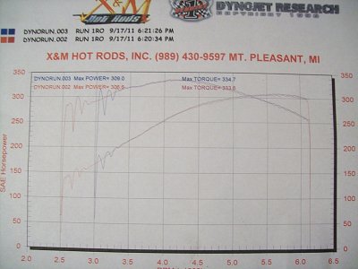

309rwhp/334rwtq NA GT40P Mustang. Got ole' TOOSLO back on the dyno this eve.
TooSlo86
So, after the 7 hours I spent driving all over South-Eastern MI today picking up parts from a couple of forum members (THOR84GT & 1mean85gt) I went over to my buddies place where they were having a Dyno Party. Mind you, 98% of the vehicles there were nasty Cummins diesels, but what-ever. Anyway, since I wanted to get a baseline before I installed the aluminum driveshaft and a set of roller rockers I picked up today (knowing I was having this same dyno at my place in 2wks) I said the hell with it and auntie-d up. Damn am I ever glad I did!
Last year at Back to the Bricks on Livernois Dyno prior to me "really" using the Moates Quarterhorse the car put down 284rwhp/303rwtq in STD correction. Mind you, this is a 125K+ mile factory untouched Ford built 1997 Explorer GT40P LONG BLOCK (that means heads have never been off to port) with my cam, pushrods, retainers, valve springs, upper/lower EFI intake, yada, yada, your normal bolt on stuff. So what did it do today you ask???? Oh wait, you don't care.....well, I'm sure that there are plenty of NA 12 second guys out there, hell, 13 second guys on aluminum heads, that care, or will give me absolute s__t about this as I've already seen at the track so, I will entertain, cuz isn't that what all this is about anyhow? Serious as a heart attack though, she blew my mind and laid down 309/334 at the wheels. The dyno owner and his business partner were blown away since they are both fox body guys and the one guy said he was a bit depressed since his T/F headed 302 wouldn't make those #'s. Am I getting a big head? Nope, just realizing the fruit of my labors over the years of constantly tweaking/tuning it. S__T is bad arse.
Do you doubt it? Come on up to my place Oct. 1st for MY dyno day. Anyone interested please pm me and I'll get you the info. I would REALLY like to see some more Mustangs represent up here! And lest you think that I only want Mustangs, I am a converted die hard F-Body freak, and my brother in law with his '02 WS-6 will be there, along with some old school Buick guys, man I could care less what it is, as long as it makes some noise up there while the rest of us sit back and drink beer!dyno.jpg

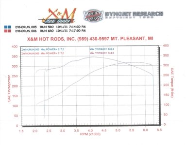

New #'s with FRPP roller rockers and FRPP aluminum driveshaft from Thor
Well we did it, we had our dyno party this past saturday. I got the FRPP roller rockers in and the FRPP driveshaft. In the end they were worth 8hp and 12lb/ft, this wasn't just at peak, with the pulls overlayed I picked up throughout the range. Granted this was done on different days but same dyno, same correction factor (SAE). So now the #'s are 317rwhp and 346rwtq. It was a great day, we had a total of 9 cars and trucks run, and man there were some cool ones! My poor little 302 was 2nd from the bottom as far as HP/TQ, but it was also the smallest engine on there too. I did get 2 good datalogs from the pulls also.race small.jpg

That's exactly what the dyno owner was saying, he's a fox body guy himself and so is his business partner who said he was jealous because his TFS headed 302 only cranked out 301. Only thing I can say is, tweak, tweak, tweak. And do alot of homework before throwing a combo together. It took me a while to determine what cam I wanted to go with. Many years of dialing it in and little things here and there. The quarterhorse tuner hasn't hurt as a year ago before that it only made 284/303. It's shown at the track too, with a year ago being able to knock down a 12.56@108 and this year it went 12.47@110 so far. I'm still a far cry from what I would like to see out of it, just check out the Factory Stocks in the NMRA, granted, in the current years they have way too much $$ in their bottom ends, but back when they had to run stock cams there were guys in the 11's with less than what I'm running.

Ok, but you have to remember, that auto is eating up alot more HP in parasitic loss than my 5 speed too. Also, are you running on a stock tune? The dyno owners buddy with the TFS heads hasn't put a tune on it other than for idle. So it's no doubt he's got alot to gain still, even as mild a set up as mine is on the stock tune the car ran like crap, I have actually noticed more in terms of drive-ability than flat out WOT. And I have plenty of opportunity to notice it too, in the summer months I drive the car 85 miles a day which lends itself to a whole lot of tuning opportunities. My fuel mileage has increased nearly 3mpg also.

It's an AFM B-21 blower cam, but like I said, I didn't just settle on it, I did a lot of running cams through engine simulators to find not the best HP cam but the one that got the car through the 1/4 with the best times and even though it is a blower cam designed for 1.7 rockers it is the one that worked the best on the simulators. That's another place where the dyno owners buddy differs, he is running an alphabet cam and stock gt40 intake and is amazed how mine pulled all the way strong to 6k where his drops off around 5400. Speaking of 1.7 ratio rockers, when I finally went and decided on these FRPP rockers I stuck with the stock 1.6 ratio because Anderson Ford couldn't tell me for sure that I would have good p/v clearance on the explorer long block. They said no problem if it was the factory H.O. but didn't have experience with the GT40P long block, not to mention the heads are pretty well done flowing at .4-.45 lift and even with the 1.6 rockers I'm already beyond that in terms of lift so I couldn't see pushing the lift even more with the 1.7's.

It's a Moates Quarterhorse and I use Binary Editor from Clint Garrity for software, it's the greatest thing, it's WAY less $ than a PMS, and from what I've seen, just as powerful. I almost went with a chip burner and chips when I purchased it but the guys at Moates advised against it unless I was a tuning/dyno shop, said I would regret having to pull the chip and burn it on the bench everytime I wanted to make a change, damn am I glad I listened to them. Yes, it's a 70MM professional products TB and EGR spacer to compliment the professional products typhoon intake (edelbrock rpm knockoff) and I run Ford blue top 24lbers and a Holley 190lph pump.
I'm still working at getting my videos from saturdays dyno day up on YouTube and assuming it successfully uploaded when I left this morning my 317-346 pull is posted on my channel without a name other than what the camera calls it, you can check it out at TOOSLO86 channel, I'll get it named and other pulls from the day posted later and put a link up. Speaking of other pulls now, I had to use my first pull to see what this thing did in the same fashion I drive it to work everyday, the only differences is I run through the mufflers and keep my long belt on spinning the power steering pump, in that trim it made 302.8hp and 336lbft, after that is when I popped the race readies and put the short belt on to bypass the power steering pump, just as I do when I race it.
