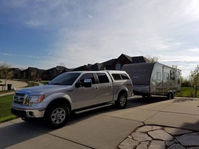

No details on the new camper? :poke:
Bought this. Was to nice and good of a deal to pass up. 31' Fleetwood Wilderness with Bunks and full slide-out. Gave me his full Hitch setup, new Tires, mint inside, new Propane Tanks full, etc... It is from our good friends who just splurged on a Brand New one. Great shape!
