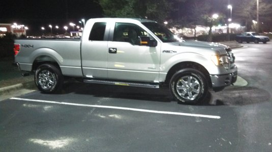

I used a 2" spacers from autospring up front. And later added a 3" block in the back. I fit a 35 perfectly on a stock rim with no rubbing even on full lock. Ride quality also improved. If were to do it again I would do a 2.5" up front since after I installed the rear block the truck had about a 1/4" rake to it.
Ill try and dig up some pictures although I sold it to another member on motown, maybe he will see this post.
http://motownmuscle.com/forums/show...Supercrew-Black-5-4L-109-000-Miles&highlight=
There is the link to the for sale ad with crappy pictures... but you get the idea.
2 inch spacer is good. Anything more and its got a Cali-lean (tall front sagging rear)
