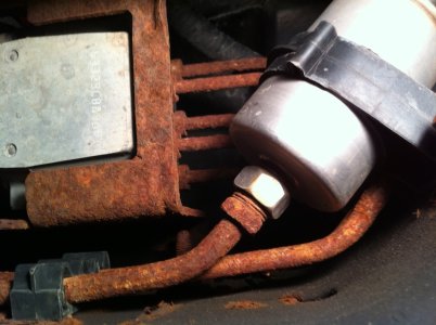

You guys and gals have a wide variety of experience, so I am interested to hear if you've experienced anything like this. I recently picked up a 2003 Yukon 4x4. It's relatively clean, has 122k on it. It's the 5.3L "Flex Fuel" engine, and has a 26 gallon tank. I have replaced the fuel filter already.

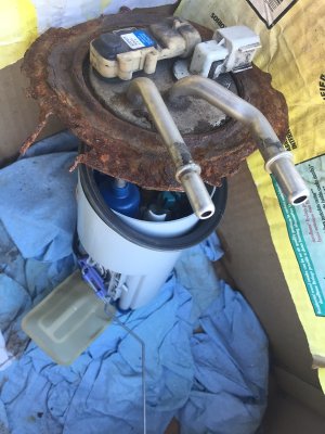

Any thoughts? Fuel pressure itself seems good. I have gotten an intermittent P0300 when I am doing 80+ on the eway, but it runs fine. When it has gas in the tank, it fires up right away and smoothly be it warm or cold. It's almost like the pump is hanging too high in the tank, but the fuel sending unit is actually reporting properly.
I have no way of knowing whether the pump was ever replaced, but I doubt that it was.
