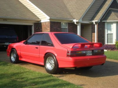

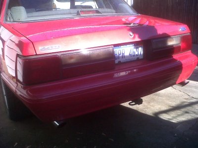

Well I’ve had this car for over 3 years so I should probably do something with it. I bought it turn-key ready to go but things are never the way you want them. It’s a clean rust free car from TN but it had so many issues I’ve only driven it once.
The initial rundown;
Engine:
Dart block
331 cu in. 3.25 stroke 5.4 rod
Canfield Heads
Trick flow intake
70 mm throttle body
Comp Cams .561/.561 248/254
Vortech YSI
Classic FAST EFI
Aeromotive pump, 60 lbs injectors
Drivetrain:
C4, PTC converter
JW bell housing
3.55 gears
Moser 31 spline axles
Detroit true loc
Qa1 tubular k- member, A-arms and coilovers

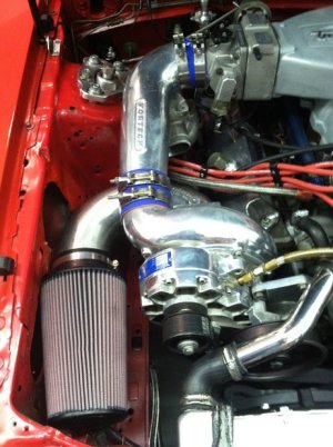

I hated the loud blower in the garage and dealing with the belt was a pain so I sold the kit.

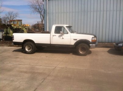

Picking it up in TN
%u00252521B0Y%u002525213HgEWk%u0025257E%u00252524%u00252528KGrHqYOKj%u00252521E%u00252529Olf%u00.jpg
%u00252521B0Y%u00252521y6%u00252521EGk%u0025257E%u00252524%u00252528KGrHqYOKjwEwrt33uqmBM%u00252.jpg
%u00252521B0YBC-wCWk%u0025257E%u00252524%u00252528KGrHqQOKkQE%u00252529Oi5BMnLBM%u0025252CEfCtu7.jpg
YSI

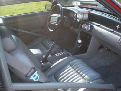

The interior needed to be freshened up so I painted the cage, replace the carpet and mounted a set of Kirkeys.
Need to upload a finished pic.

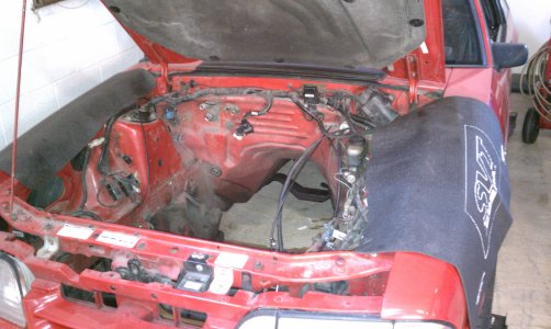

The engine bay needs some love with holes welded and ScottRodFab panels. Hopefully this thread will motivate me to work on it this weekend.

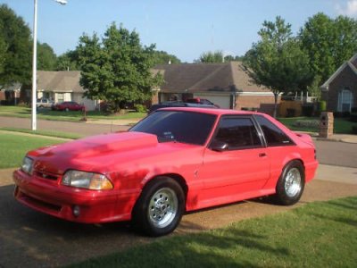

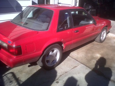

How it sits right now.

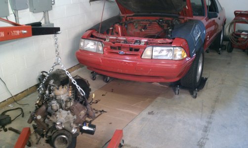

I received the Scottrodfab panels, trans stuff, and a mock up block courtesy of Oldbutnew. Just waiting on the intercooler to start fabbing turbo mounts.
The shortblock took little longer than expected. Some of the changes:
- Engine builder recommend tool steel pins, ordered Trend’s with the Motown discount
- Rod bushings needed to be replaced and honed to size
- Crank was undersized for balancer not providing the interference fit– welded and reground to size
The assembly was balanced and everything looks good now. On to the next issue was the heads, the seats looked like they weren’t pressed in the heads correctly so after reviewing the issue with the builder we recommended new seats and blending into the combustion chamber with a new valve job. I get a call later in the day and find out of the heads are cracked on the exhaust side the builder recommended not using them. I did a quick google and sure enough it’s a common problem with Canfields with part numbers 20-450-58-0. They fixed the casting issue and revised the part number to 20-475. Fixing the heads would cost upward of $1200 so we opted for a set of AFR 205 with 58cc chambers. I’m going to drop the heads off this weekend to get the o–ring grooves cut in and hopefully have them mounted next week. The exhaust ports are raised .125 so hopefully the turbo kit will still fit.
