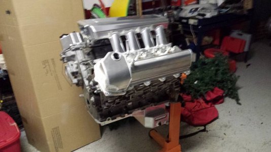

Well I guess its time to get this party started.....
08 mustang GT 4.6L 5 speed.. made 520hp at the wheels with a turbonetics kit..... "blowed da hell up" on the way to the woodward dream cruise 2010......
Fast foward to now.... time to get this 19,000mile pony working again....
goals: 1000hp to the rear wheels ....street drivin.... want a vintage "A/Fx" look with some modern anemitys the cosmetics will be a little later....
the parts collected so far....
stock block honed slightly oversize for the new CP pistons.
longer stroke K1 crank (5.0L displacement)
Manly H-beams with ARP 2000 rod bolts...
ARP everything for a 3v
heads.... Ferrea valves, PAC springs have to ship them off to Fox lake here soon...
cams: will be custom
intake: Holley sniper

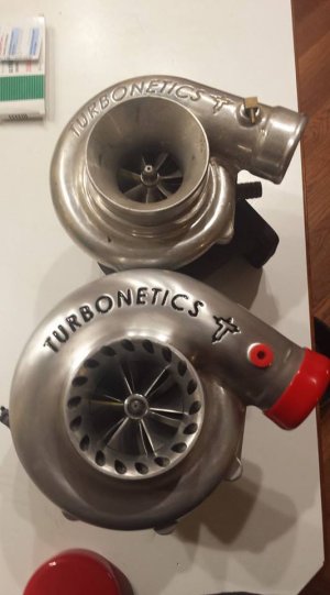

old turbo was a 62mm turbonetics... new one is a GTK-1000 with a wet housing.
wastegate and BOV are Synapse
hot and cold sections custom made By Mizzi.
Ford performance parts oil pump coated and ported...
evans coolant...
The pretty:
Moroso fabricated cam covers, oil pan, coolant tank power steering tank, PNR welding fabricated catch can.... mitsumoto radiator.
the underpinnings: full BMR suspension front and rear
on the "to get" list.
magnum XL Tr6060 wide ratio
Mcleoud twin disc
rocket wheels launcher series front wheels and the gasser style rear wheels in "dull magnesium"
H.O. fibertrends reverse tear drop hood.
that is about all I have for the moment.. will post a few pictures while I can.
I bought the rotating Assembly before the coyote came out and its pretty easy to make the power I want with boost.... so why not? :)

Thanks Denny... yeah the original thought was to just get another 62mm and spin 2 of them.... but.. Mizzi and I debated that.. he made a good point when he said boost would come on REALLY quick with twins... almost too quick for thestreet.... so he won this one LOL!

Turbo should be here tomorrow... willpost pictures then...I'm trying to find a picture of the metco pullys I got last week....
