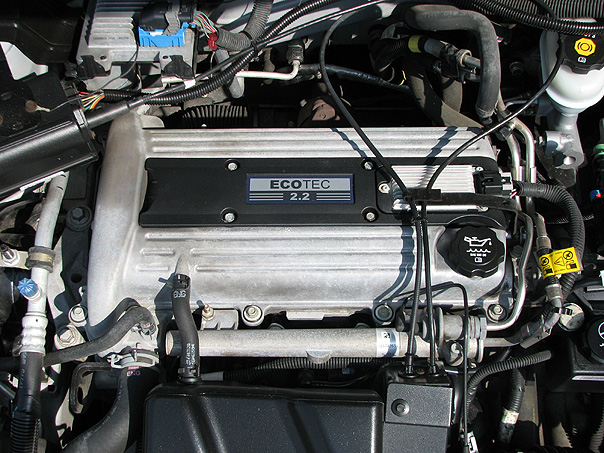

my fiance's has an 03 cavalier with the 2.2 ecotech motor and when the temp gets below 65 and its wet or damp outside the car will randomly stall when slowing down coming to lights. It was doing it all last winter and i thought i fixed the problem by replacing the pcm. It does not stall when its dry out and warm. I checked the fuel pressure, all the engine grounds. Watched all the sensor outputs on a tech 2 and it has no check engine light. I could not find a broken wire and i checked the spark plugs and there all good. I cleaned the throttle body, checked and cleaned the intake tubing. I checked for vacuum leaks and found nothing. I thought it mite have been the IAC but i replaced that as well with no luck. SO anyone have any ideas where to go now. I dont want to throw parts at it and i cant get it to act up on a regular bases to properly diagnose the problem. So any help would be greatly appreciated.
